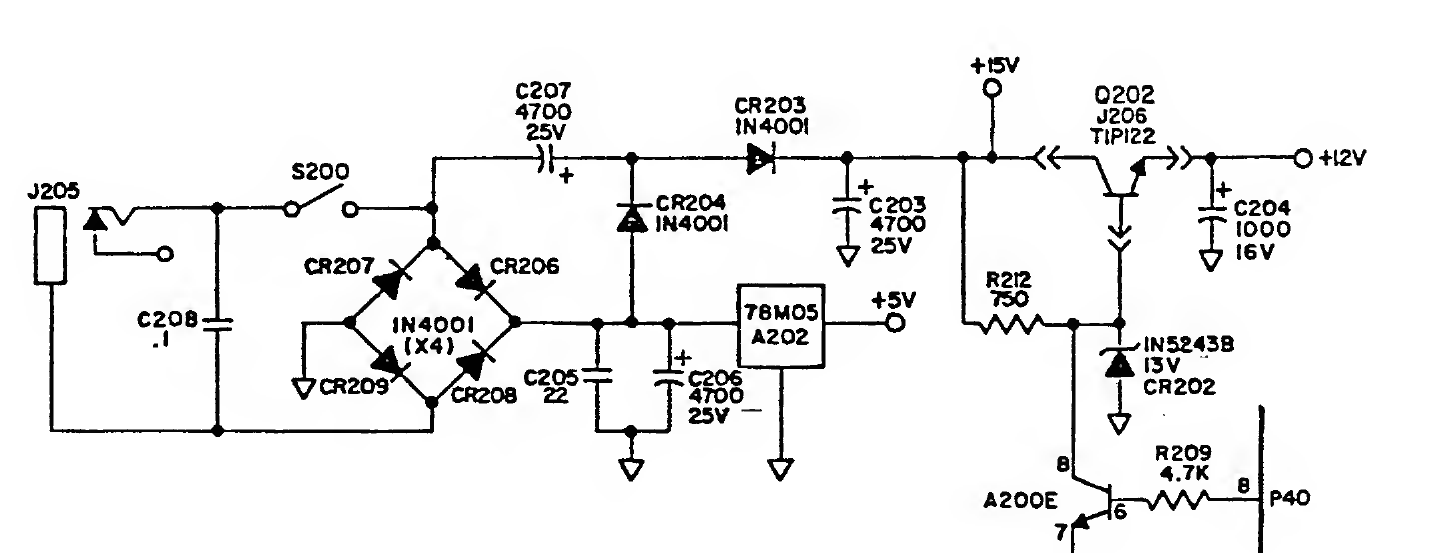

Power supply circuit of the Atari 822 thermal printer board, from Atari technical specification TS015897-01: the 9 V AC input J205 and C208, the power switch S200, the bridge CR206 to CR209 with C205 and C206 feeding the 78M05 regulator A202 for +5 V, the voltage doubler C207 and CR204 with CR203 and C203 for +15 V, and the TIP122 Q202 with the 13 V zener CR202 and C204 for +12 V.
