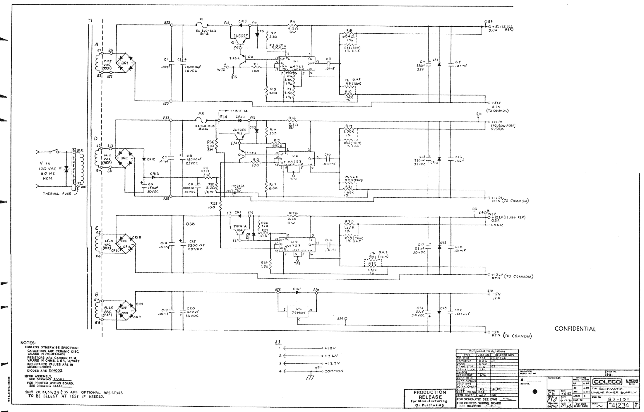

Coleco drawing 41234 revision E, "Schematic, Linear Power Supply", used on 83-101: the Adam power supply board in the SmartWRITER printer. It shows the transformer with thermal fuse, the four rectifier and regulator sections (+5 V, +12 V inductive, +12 V logic and −5 V), the µA723 regulators, the 2N3055, TIP31A and TIP41A pass and driver transistors, the 79M05, the 5 A slow-blow fuses and every capacitor value. Rendered from sheet 7 of the hosted schematic set and reduced to 16 grey levels.
File:Coleco Adam Schematics.pdf, sheet 7, from colecovisionadam.com (retrieved 2026-10-06).
