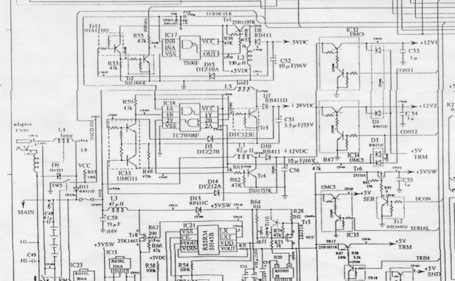

File:Sharp BO-A300 power supply circuit (service manual schematic).png
Size of this preview: 800 × 494 pixels. Other resolution: 890 × 550 pixels.
Original file (890 × 550 pixels, file size: 256 KB, MIME type: image/png)
[edit | edit source]Crop of the power supply section of the circuit diagram in Sharp's BO-A300 (original Newton MessagePad) service manual, showing IC17, IC18, IC21 and capacitors C51 (3.3 µF 35 V), C52 and C59 (33 µF 16 V). The scan is cut off at the bottom of the sheet.
[edit | edit source]Rendered from File:Sharp BO-A300 Newton MessagePad Service Manual.pdf, PDF p. 37.
