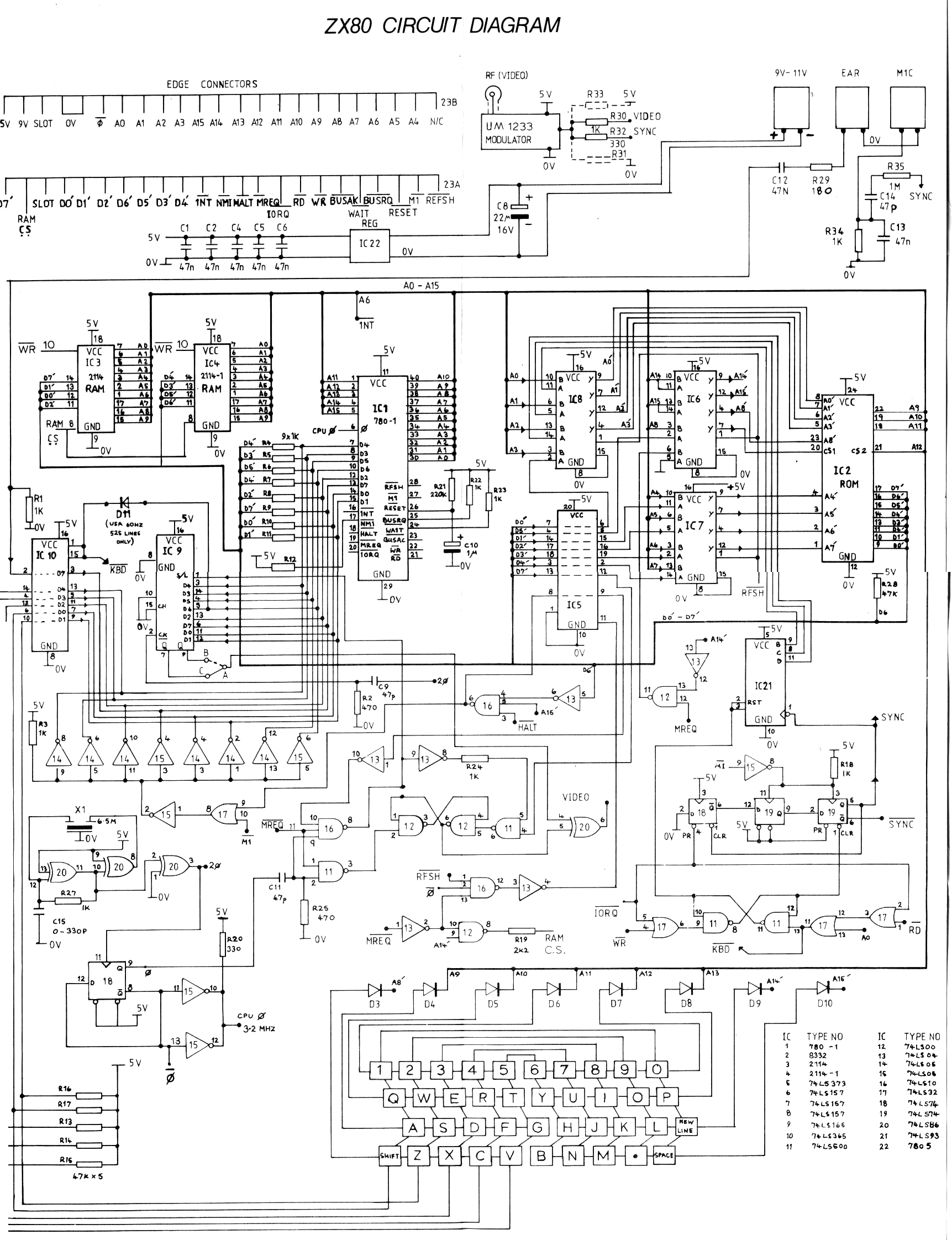

File:Sinclair ZX80 circuit diagram.png
Original file (1,723 ร— 2,244 pixels, file size: 445 KB, MIME type: image/png)
Description Sinclair ZX80 circuit diagram as published by Sinclair Research. Shows the 9 V - 11 V DC input with its 22 uF 16 V reservoir C8, the IC22 7805 regulator and the five 47 nF rail decouplers C1, C2, C4, C5 and C6, the R21/C10 power-on reset network on the Z80 (IC1), the 6.5 MHz crystal X1 and 3.25 MHz CPU clock, the 2114 static RAMs (IC3, IC4), the 8332 ROM (IC2), the all-discrete 74LS video and sync logic (the ZX80 has no ULA) and the UM1233 modulator. Also carries Sinclair's edge-connector pinout and the IC type list.
