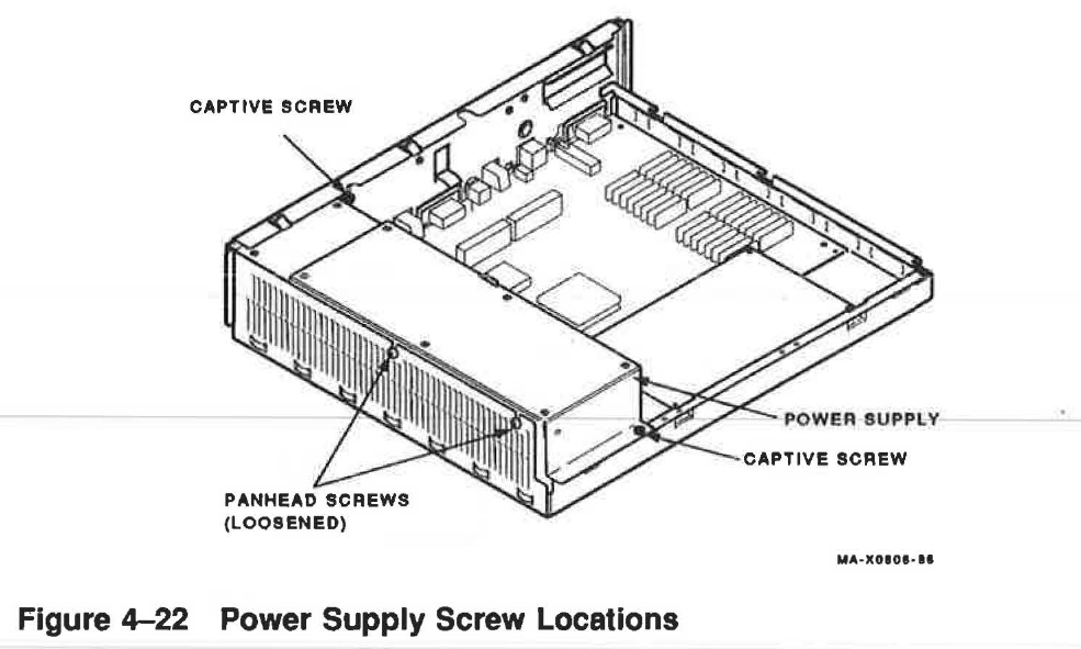

File:VAXstation 3100 Model 30 power supply screw locations (EK-285AA-MG-001 Figure 4-22).png

[edit | edit source]DEC's drawing of the VAXstation 3100 Model 30 system box with the power supply, its pan-head screws and the captive screws marked. Figure 4-22 of the VAXstation 3100 Maintenance Guide, EK-285AA-MG-001, p. 106, rendered from the scan.
[edit | edit source]File:VAXstation 3100 Maintenance Guide (EK-285AA-MG-001).pdf, p. 106 (PDF page 127).
[edit | edit source]Copyright Digital Equipment Corporation. Manufacturer documentation, used to identify the product and for repair reference.
