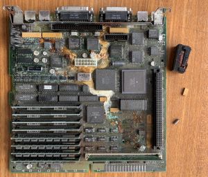

PRAM Battery Handling
[edit | edit source]The Macintosh SE/30 uses a 3.6V 1/2AA lithium PRAM battery to store time and system settings. These batteries can leak over time, damaging the logic board.
Best Practices
[edit | edit source]- Inspect the battery annually for swelling, corrosion, or leakage.
- If storing the SE/30 long-term, remove the battery entirely.
- Replace only with high-quality 3.6V lithium cells (e.g., Tadiran or Saft).
- Observe correct polarity during replacement (usually '+' faces up).
Dealing with Corrosion
[edit | edit source]- Neutralize corrosion with white vinegar, followed by a rinse with isopropyl alcohol.
- For serious damage, traces may need to be repaired using a conductive trace pen or jumpers.

PRAM Battery Damage
[edit | edit source]Battery leakage can affect nearby circuits, including:
- Reset/clock circuit
- RTC and VIA chips
Check for green/white corrosion and verify continuity across damaged areas with a multimeter.
