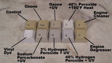

Keycaps from one keyboard after different treatments, labelled in the image: a control, ozone, ozone with UV, peroxide with heat, peroxide with UV at two strengths, sodium percarbonate with UV, vinyl dye, engine cleaner and engine degreaser.

Jueden also tried heating a solution of 40-volume developer and water with a sous-vide circulator, which lightened the plastic without fully restoring it, and ozone with UV, which gave negligible or worse results.[2]
