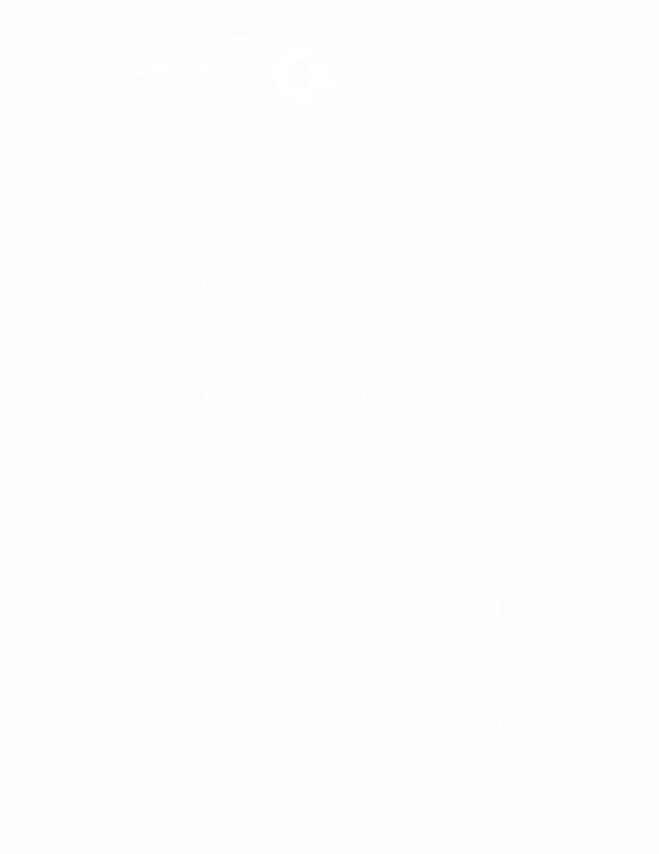

Sheet 3 of Commodore's Display Assembly Component Cross Reference for the Commodore PET 2001 — the remaining resistors, the spark gaps, the transformers and the regulator. Commodore Business Machines, Inc., Palo Alto, California, scanned at 400 dpi. The list is numbered 1–70 across the three sheets.

{{| class="wikitable styled-table" |- ! Ref !! Description !! Commodore part no. |- | R35 || 4.7 k 1/4 W 5 % || 901550-19 |- | R36 || 560 Ω 1/4 W 5 % || 901550-30 |- | R38 || 470 Ω 1/4 W 5 % || 901550-58 |- | R39 || 270 Ω 1/4 W 5 % || 901550-76 |- | R40 || 220 Ω 1/4 W 5 % || 901550-52 |- | R42 || 10 Ω 1/2 W 5 % || 901600-14 |- | R43 || 120 Ω 1/4 W 5 % || 901550-75 |- | SG1–SG3 || 0.01, 20 %, spark gap, Gap-103 || 900040-01 |- | SG4 || 0.75 pF spark gap, Gap-R75 || 900040-02 |- | T1 || Mains transformer — Marvel M594A1A || 902450-02 |- | T2 || Flyback transformer || 902475-03 |- | VR1 || Voltage regulator || 901527-01 |- | — || CRT tube connector || 903150-01 |- | — || #6-32 hex nut (heatsink) || 905950-02 |- | — || #6-32 × 0.5 Phillips screw (heatsink) || 906610-02 |- | — || Yoke assembly || 320078 |- | — || PCB || 320084-02 |}}
Three things this sheet settles.
- VR1 is a 7812. The parts list says only "voltage regulator, 901527-01", but the component-placement drawing at Video Board Parts Layout marks the position "VR1 7812 UC", and the same Commodore part number 901527-01 appears as an MC7812CT in Commodore's later service documentation. The display assembly's regulated output is +12 V.
- The four spark gaps are real components, not board features: SG1–SG3 are 0.01 / 1.5 kV types and SG4 is a 0.75 pF type. They protect against flashover and are easy to mistake for damaged parts.
- The yoke and the bare PCB have their own Commodore part numbers — 320078 and 320084-02 — in the same 320xxx series as the schematics.
