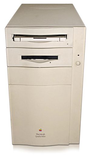

Macintosh Quadra 840AV. Source: Wikimedia Commons.
