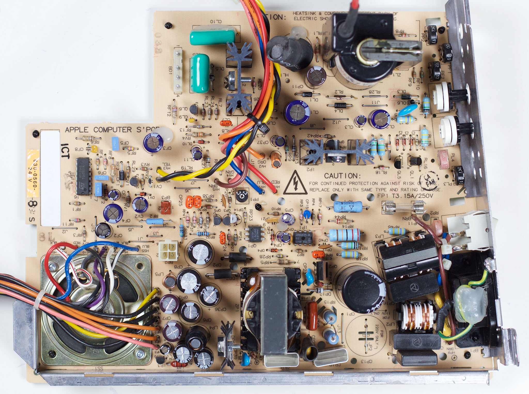

Analog Board Components
  • Fuse (F1)
  • Rectifiers CR2 and CR3
  • Transistor Q2
  • Resistor R22
  • Startup circuit near the power input section
  • Analog board solder joints (especially around the flyback transformer)

โšก Analog Board Instability
The analog board provides video, power, and audio, and is a common point of failure.
Common Faults
  • Failing capacitors leading to distorted video or unstable voltages
  • Clicking or pulsing: Failed CR2/CR3 diodes, Q2 transistor, or R22
  • No video or sound despite fan: Bad flyback transformer or failed analog board controller
