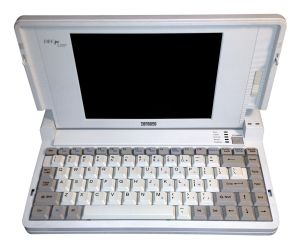

DECpc 320P Troubleshooting Guide
Fault-finding for the DECpc 320P, using GRiD's user guide for the GRiD 1755, the same design; the 320P's rating label carries the number 1755.[1][2] Battery faults are covered on DECpc 320P Battery Replacement.
