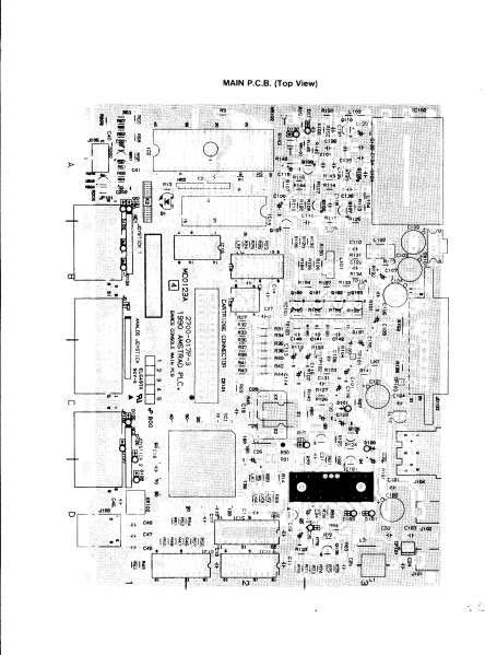

File:Amstrad GX4000 main PCB layout.png
Original file (1,604 × 2,163 pixels, file size: 213 KB, MIME type: image/png)
The GX4000 main printed circuit board, top view, as drawn on printed page 24 of Amstrad's Plus range service manual. The drawn board is marked MC0123A, 2700-017P-3, ©1990 Amstrad plc, Games Console Main PCB, and shows component positions and circuit references.
Rendered from page 58 of the hosted File:Amstrad GX4000 Service Manual.pdf (printed page 24).
Amstrad plc.
Copyright Amstrad plc. Hosted for preservation and repair reference, with the source cited.
