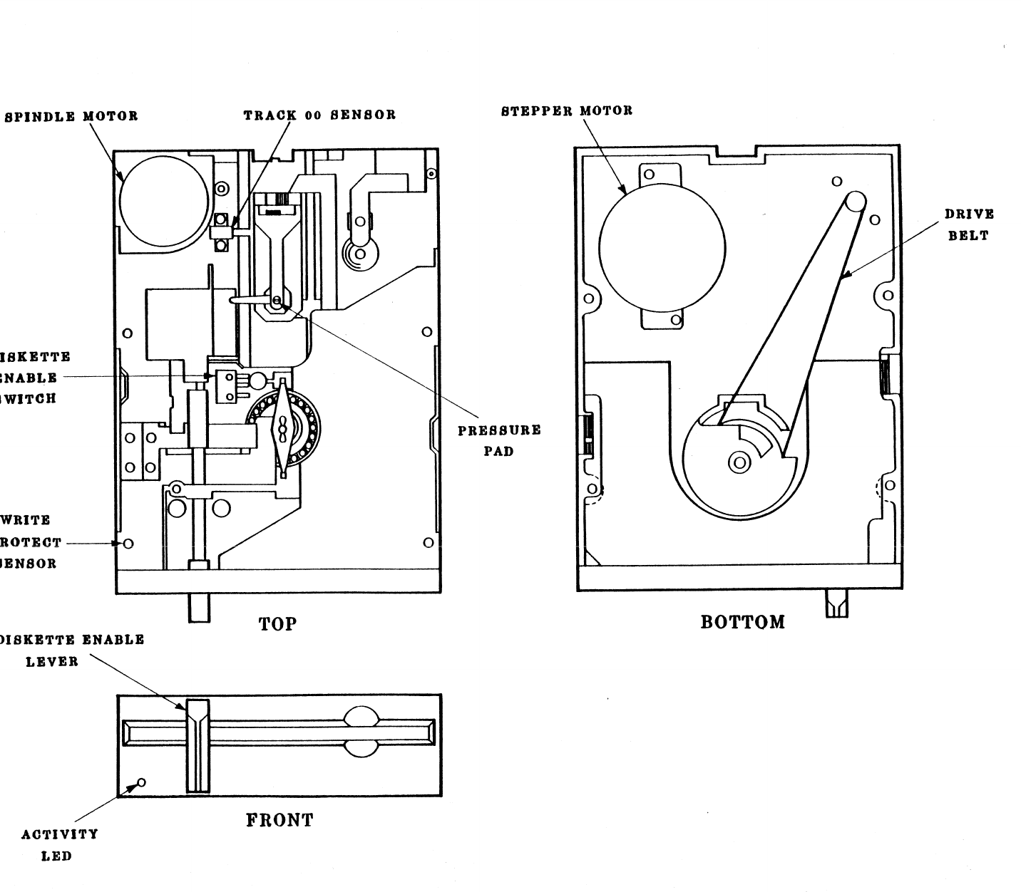

[edit | edit source]Figure 2-2, "Adjustment Points", from Atari's 1050 Disk Drive Field Service Manual (FD100330), page 2-7, rotated to read horizontally. It locates the spindle motor, track 00 sensor, pressure pad, diskette enable switch and lever, write protect sensor, activity LED, stepper motor and drive belt on the Tandon drive mechanism.
[edit | edit source]Rendered at 150 dpi from File:Atari 1050 Disk Drive Field Service Manual.pdf (the rebuilt scan on the Internet Archive, item 1050FSMRebuiltAKH), page 35 of the PDF, 2026-10-01.
