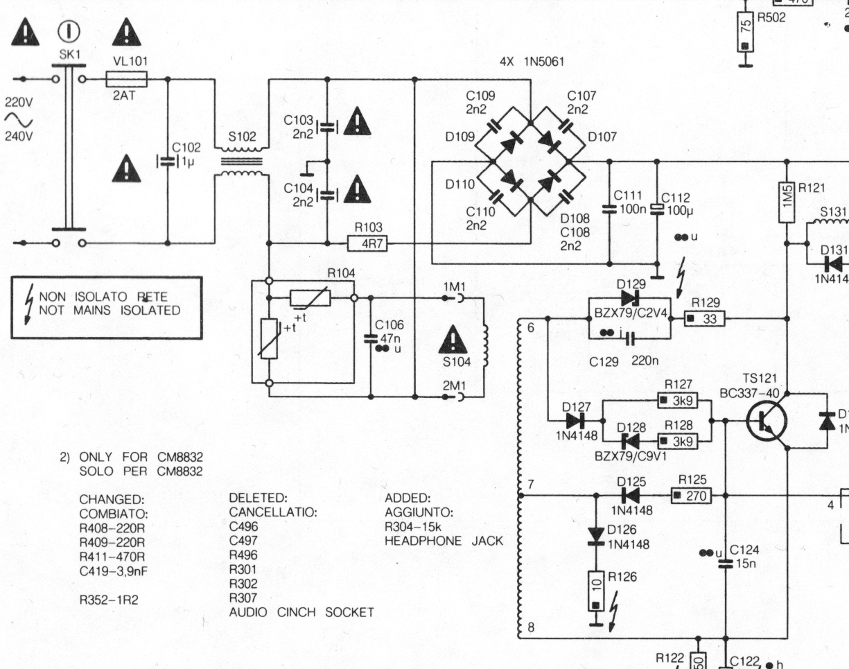

The mains input and the start of the switch-mode power supply on the Philips CM8852/CM8832 schematic supplied with the Atari SC1425: mains switch SK1, fuse VL101 (2AT), filter S102, bridge D107 to D110 (1N5061) with C112 (100 µF), the degaussing circuit (R104, S104) and the "not mains isolated" warning, with the box of CM8832 changes. Cropped from page 1 of File:Atari SC1425 Schematic (Philips CM8852 and CM8832).pdf.
Cropped from File:Atari SC1425 Schematic (Philips CM8852 and CM8832).pdf, page 1. Scanned by gligli from the paper schematic supplied with an Atari SC1425 and shared on Atari-Forum on 2 January 2026 (thread); downloaded from the poster's link, sfx.gligli.free.fr/bordel/atari_sc1425_sch.7z (retrieved 2026-10-04).
