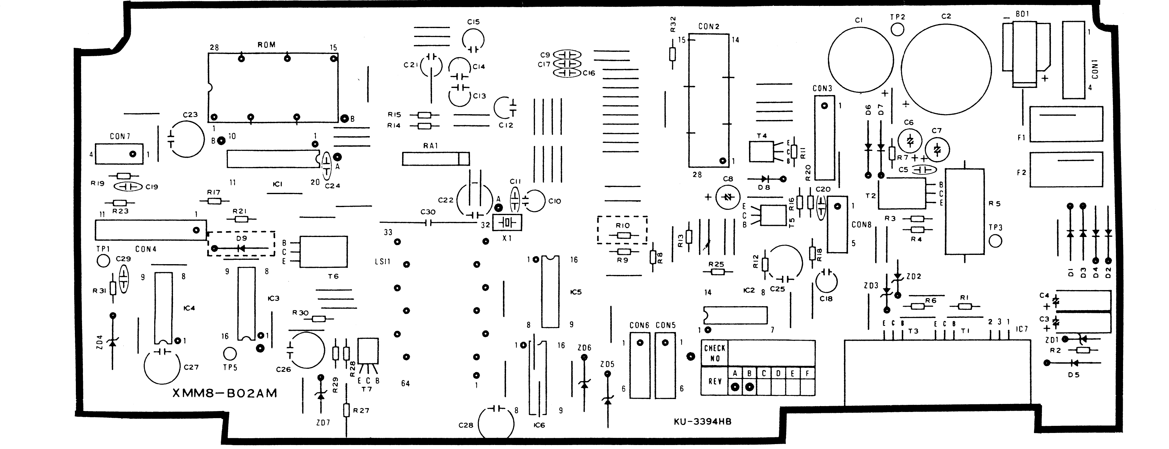

File:Atari XMM801 main board layout (FSM Figure 19).png
Original file (3,791 × 1,455 pixels, file size: 151 KB, MIME type: image/png)
Component layout of the Atari XMM801 main control board, XMM8-B02AM (board marking KU-3394HB), from Figure 19 ("Parts Layout and Pattern Schematic") on page 11 of Atari's XMM801 Field Service Manual, CO 70435, October 1985. Rendered at 300 dpi from the scan and cropped to the component side; the copper pattern drawing below it in the manual is not included.
Internet Archive item atari-xmm-801-field-service-manual-atari-corp, PDF page 17, retrieved 2026-10-06. The complete manual is hosted here as File:Atari XMM801 Field Service Manual C070435.pdf.
