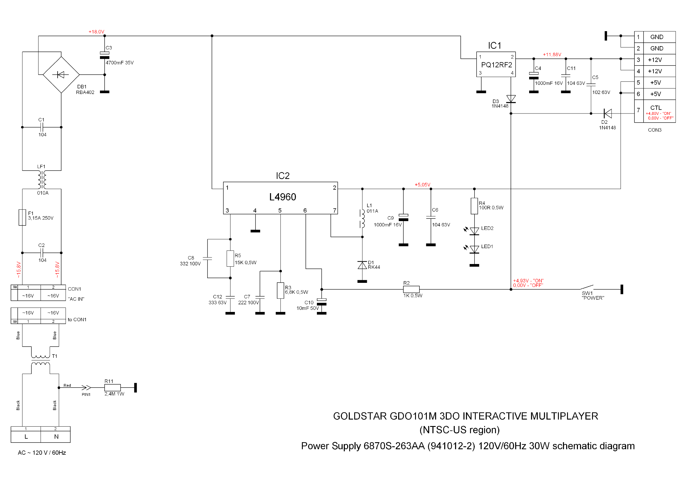

Schematic of the GoldStar GDO-101M power supply board 6870S-263AA (941012-2), 120 V 60 Hz 30 W, NTSC-US model: mains transformer T1, fuse F1 3.15 A, bridge DB1 RBA402, reservoir C3 4700 µF 35 V, L4960 switching regulator for +5 V, PQ12RF2 regulator for +12 V and the seven-pin output connector CON3, with measured voltages in red. Rendered at 200 dpi from File:GoldStar 3DO GDO-101M Power Supply 6870S-263AA Schematic.pdf and rotated to read horizontally.

A community redrawing traced from a GoldStar board; the drawer is not named at the source. It is not a GoldStar document.
