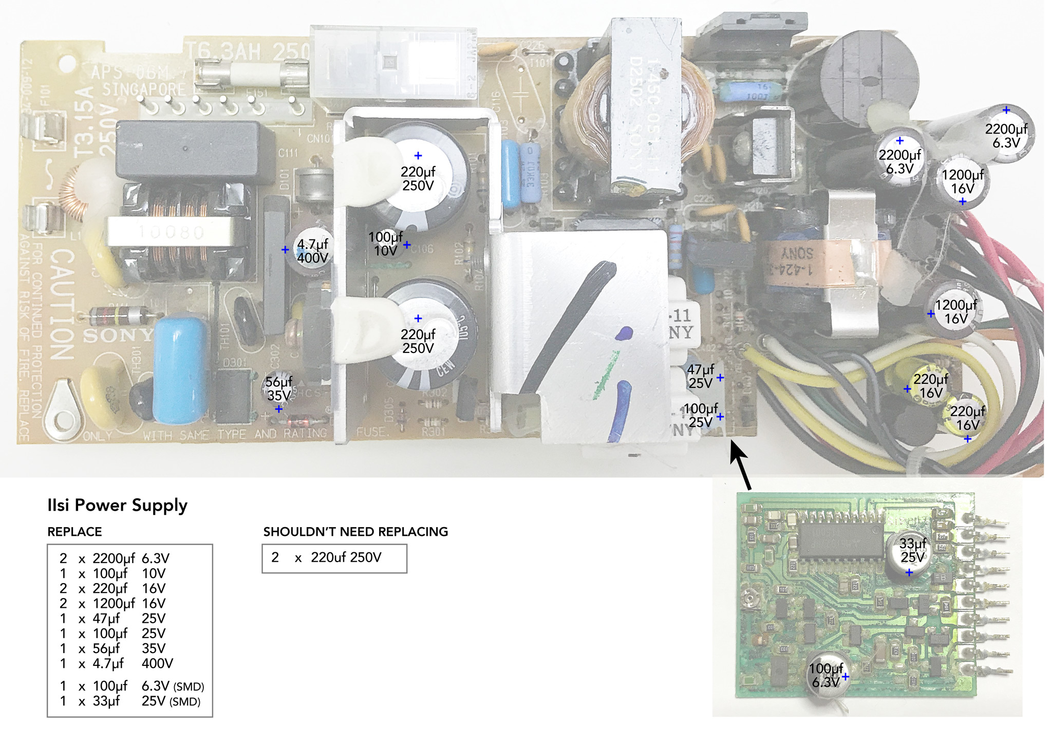

Recap-a-Mac's annotated photograph of the Sony APS-06M power supply from the Macintosh IIsi, with each electrolytic capacitor marked with its value, working voltage and positive terminal, the small control board shown separately, and a list of the parts to replace (2 × 2200 µF 6.3 V, 1 × 100 µF 10 V, 2 × 220 µF 16 V, 2 × 1200 µF 16 V, 1 × 47 µF 25 V, 1 × 100 µF 25 V, 1 × 56 µF 35 V, 1 × 4.7 µF 400 V, and on the control board 1 × 100 µF 6.3 V and 1 × 33 µF 25 V surface-mount). The two 220 µF 250 V primary capacitors are marked as not normally needing replacement.
