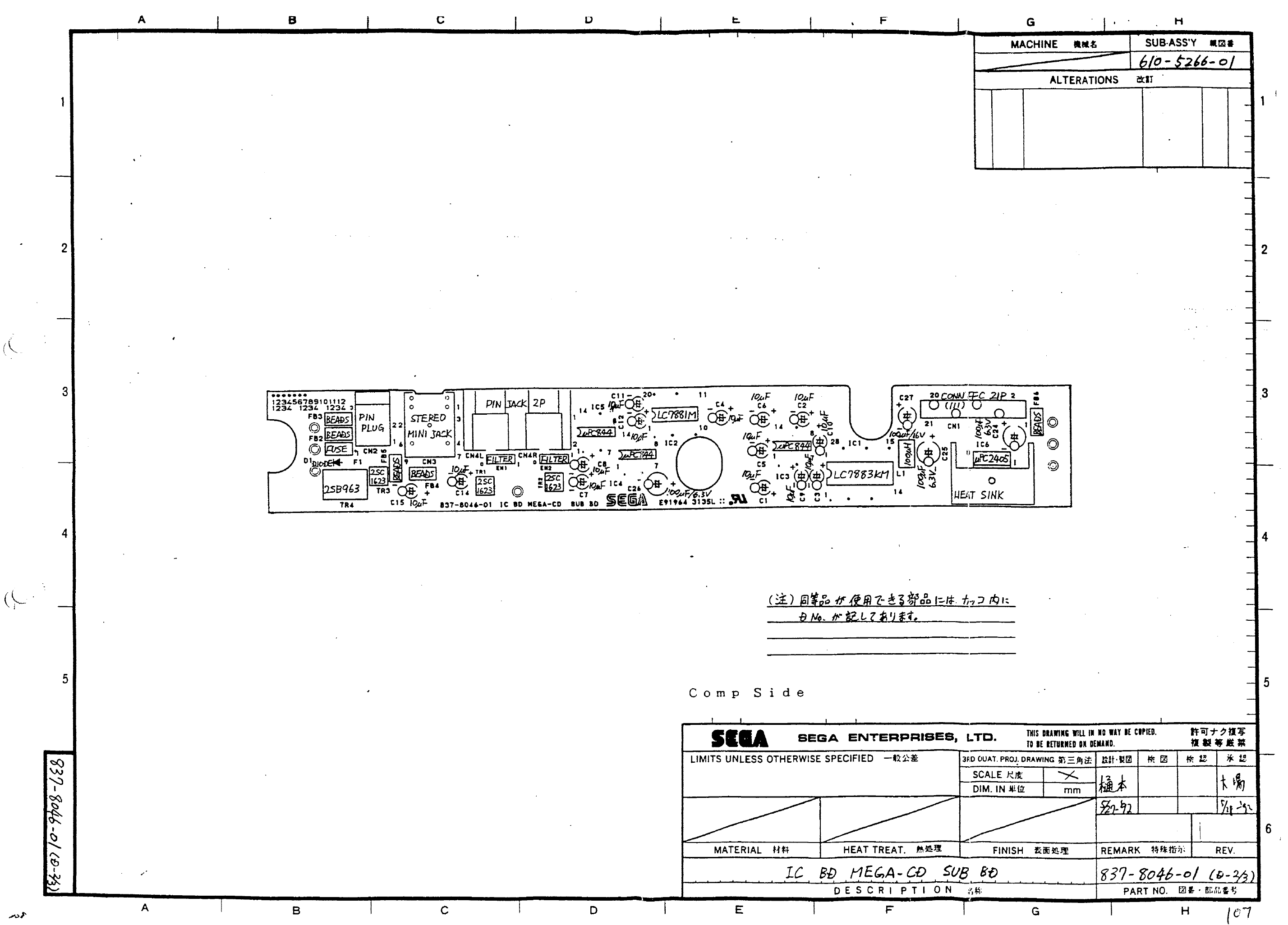

Sega's mount diagram (component side) for the 837-8046-01 IC BD MEGA-CD SUB BD of the front-loading Sega CD (Model 1): DC input, fuse F1, the µPC2405 regulator, the LC7883KM digital filter, the LC7881M DAC, three µPC844 op-amps, the mix-in and line-out jacks, and CN1 to the main board. The same manual's parts list covers the later export boards 837-8952 and 837-8953, whose designators differ.
Rendered from page 107 of the MEGA-CD Maintenance Manual, Export, August 1992, Rev. A of File:Sega CD Service Manual.pdf, converted to greyscale PNG. Nothing else is altered.
