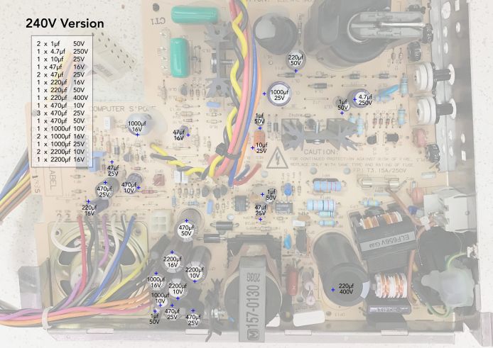

Macintosh Classic Capacitor List
Analog Board Capacitors
The Macintosh Classic analog board has several capacitors that may require replacement. Due to variations in board revisions, consult the specific schematic for your model. Common capacitor values include:
Macintosh Classic Analog Board Capacitor Specifications
Label Capacitance Voltage Quantity
CF3 1000µF 16V 1x
CF4 470µF 25V 1x
CL1 1000µF 25V 1x
CL2 4.7µF 250V 1x
CL3 1µF 50V 1x
CP1 220µF 250V 1x
CP10 470µF 25V 1x
CP11 220µF 50V 1x
CP12 1000µF 16V 1x
CP13 220µF 250V 1x
CP2 470µF 50V 1x
CP34 1µF 50V 1x
CP36 2200µF 10V 1x
CP4 47µF 25V 1x
CP5 1µF 50V 1x
CP6 2200µF 10V 1x
CP7 1000µF 10V 1x
CP8 2200µF 16V 1x
CP9 470µF 25V 1x
CV2 470µF 10V 1x
CP3 10µF 25V 1x
CP37 1µF 50V 1x
CL11 47µF 16V 1x
CF2 220µF 16V 1x
CF1 47µF 25V 1x
  • Note: Capacitor labels and values may vary between board revisions. Always verify with your specific board.*
Macintosh Classic Analog Board (INT) Recap Diagram [1]
