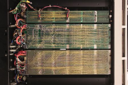

[edit | edit source]The DD11-PK is a 9-slot hex backplane. Slots 1 and 2 are wired for the processor; the rest mix standard Unibus slots, modified Unibus slots for memory and small peripheral controller (SPC) slots. The DD11-DK is the same backplane without the dedicated processor slots, used for expansion, and the DD11-CK is a 4-slot expander.[6] Power reaches each backplane through two 15-pin and one 6-pin Mate-N-Lok connectors from the power supply's distribution board.[6] Each unused SPC slot needs a G727 grant continuity card in connector D, or the bus grant chain is broken.[7]

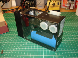

[edit | edit source]In the BA11-K the H765 power system supplies the regulators: one H745 −15 V regulator and two H744 (11/34) or H7441 (11/34A) +5 V regulators, with an H754 or H785 in the fourth slot depending on configuration. The first +5 V regulator feeds the processor backplane and the second all the others.[5][9] See PDP-11/34 Power Supply Restoration.

- H744 regulators. The commonest fault reported by restorers is the bridge rectifier; aged output capacitors make a regulator whine.[12][13]
- Backplane solder joints. Some DD11-PK backplanes have wire-wrap pins that were never properly wetted by the solder, giving intermittent opens such as a broken NPG chain.[14]

Wire-wrap side of the backplanes (Autopilot, CC BY-SA 3.0)
H744 +5 V regulator (Jonathan Chapman, Glitch Works)
