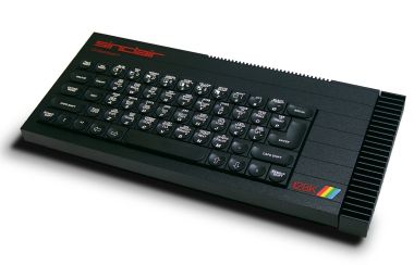

[[File:Sinclair ZX Spectrum 128.jpg|thumb|380px|Sinclair ZX Spectrum 128 "Toastrack".]]
The Sinclair ZX Spectrum 128 has a full component-level parts list in Sinclair's Service Manual, so every capacitor's designator, value, rating and type is documented. The tables below are transcribed from Table 5.4 (main PCB) and Table 5.5 (keypad PCB).[1]
