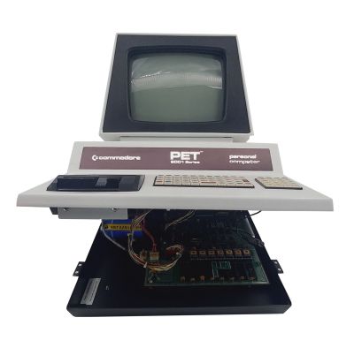

Commodore PET 2001 Service Documentation
Commodore's own service documentation for the Commodore PET 2001 survives in reasonable completeness. Four documents are hosted here, and together they cover both assemblies inside the machine at component level.
They are the source for every figure on Commodore PET 2001 Capacitor Replacement Guide.
