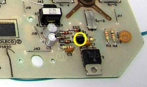

The power section of a Pac-Man board (75690): the small transformer, transistors T1 (circled) and T2, zener diodes, diodes and two electrolytic capacitors. The display supply comes from this part of the board.

  3. If power reaches the board but goes no further, suspect the transistors. On the Pac-Man board in the Handheld Museum's guide there are two, a round one (circled in its photograph) and a square one below it. Remove them and test them with a meter. The author reports fixing many dead games this way and describes the transistors as acting almost like fuses.[3]
  4. If one transistor is hot, replace or test all of them: a bad part elsewhere may have overheated it, and a new transistor fitted alone can fail the same way.[3]
  5. Check the traces for corrosion and breaks. Then test the resistors, diodes and capacitors. If everything tests good and the board is undamaged, the microcontroller has probably failed and the game needs a donor board.[3]
The Galaxian in the Build Your Own Arcade Controls thread shows how far this can go: new transistors, new capacitors and repaired tracks brought back faint sound but not the display.[5]

  3. Check the transistors as above. On a Pac-Man, a KLOV member whose board had lost its switching transistor fitted a TIP41C NPN transistor in its place, and the game worked.[2]
