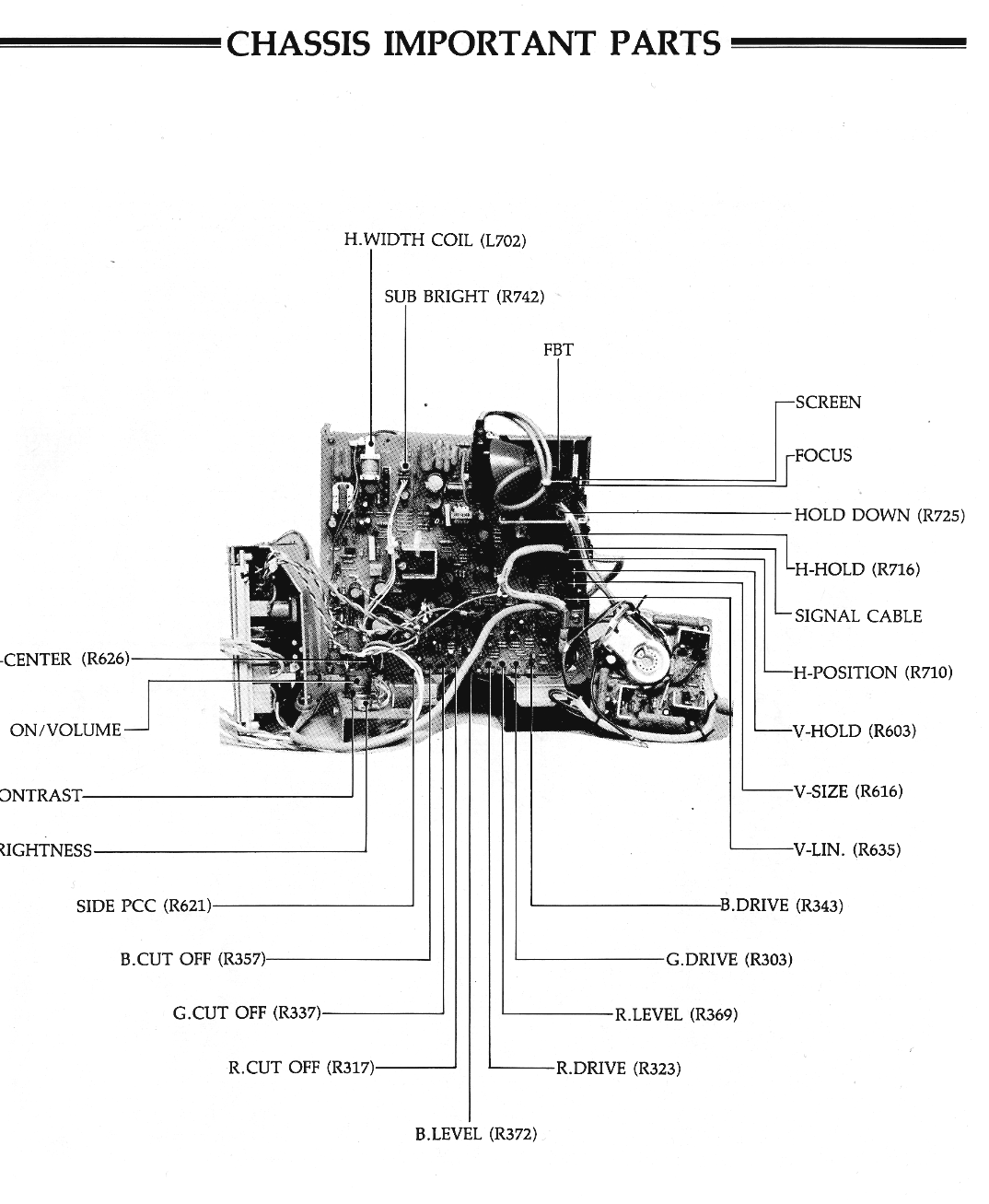

File:Atari SC1224 Goldstar CA-3 chassis adjustment points.png
Original file (1,074 × 1,307 pixels, file size: 251 KB, MIME type: image/png)
"Chassis important parts", the labelled photograph of the CA-3 chassis of the Goldstar-built Atari SC1224 from Atari's SC1224 service manual (printed page 21). It marks the user and service controls with their designators: H.WIDTH coil L702, SUB BRIGHT R742, the flyback (FBT) with its SCREEN and FOCUS controls, HOLD DOWN R725, H-HOLD R716, H-POSITION R710, V-HOLD R603, V-SIZE R616, V-LIN R635, V-CENTER R626, SIDE PCC R621, the R, G and B DRIVE, CUT OFF and LEVEL presets, and the front controls. Extracted at the scan's native 150 dpi and cropped.
Cropped from File:Atari SC1224 Service Manual (CA-3 chassis).pdf, PDF page 17.
