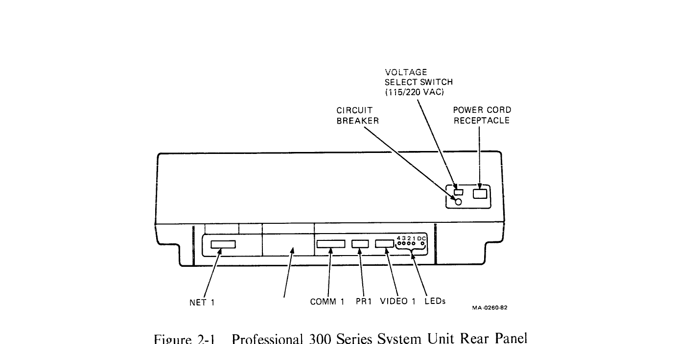

Rear panel of the Professional 300 series system unit: network, communications, printer and video connectors, the four red self-test LEDs (marked 4, 3, 2, 1) and the green DC LED, the circuit breaker, the 115/220 V voltage select switch and the power cord receptacle. Rendered from DEC's Professional 300 Series Technical Manual, Volume 1, EK-PC300-V1-001, Figure 2-1, p. 2-3.
