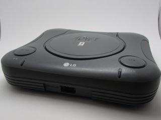

The Goldstar GDO-203 Alive II is a top-loading console with the Anvil chipset and a Hitachi laser, so little of the GDO-101M's drive work carries over to it.[1][2][3] No GoldStar service information for it has been found. The notes below come from the 3DO Development Repo and from the console's rating plate; for capacitor symptoms in general see Capacitor Failure Symptoms.
