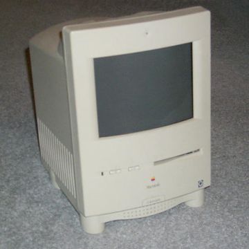

Macintosh Color Classic General Maintenance
Maintenance guidance for the Macintosh Color Classic, also sold as the Macintosh Performa 250. It is a compact Macintosh with a 10-inch Trinitron CRT, a logic board that slides out of the back, and a combined analogue board and power supply with a universal 90–240 V AC input.[1][2] The two jobs that matter most on an unrestored machine are the PRAM battery and the logic board capacitors; both are reached without opening the case.
