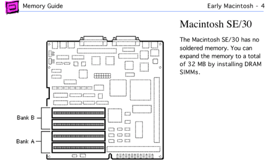

Memory Specifications
The Macintosh SE/30 features 8 30-pin SIMM sockets, organized into two banks of four. Memory must be installed correctly for proper functionality:
  • Bank A (Front 4 slots) โ€“ Must always be populated first.
  • Bank B (Rear 4 slots) โ€“ Can be left empty unless installing more than 4 MB of RAM.
The SE/30 supports memory interleaving, meaning matched SIMMs provide better performance.

Step 3: Locate the SIMM Slots The 8 memory slots are on the logic board, organized into two banks:
  • Bank A โ€“ The four front slots (closest to the edge of the board).
  • Bank B โ€“ The four rear slots (closest to the rear ports).
