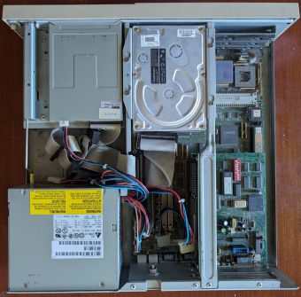

Inside a DECpc LP: drives at the top, power supply at lower left, main logic board, riser and CPU module on the right (David Hall, zx.net.nz)
