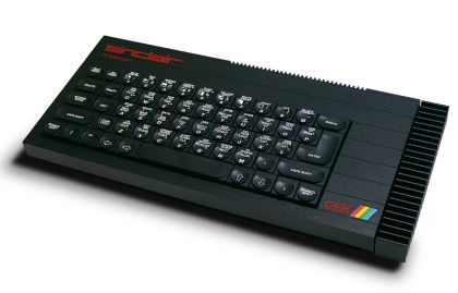

Sinclair ZX Spectrum 128 General Maintenance
This guide covers preventive maintenance for the Sinclair ZX Spectrum 128. The machine uses the Spectrum+ case and keyboard, so keyboard work is shared with that model; the heatsink, the extra RAM and the RS-232/keypad circuitry are 128-specific.
Maintenance priorities are the heatsink and its mounting, the keyboard membrane and its two ribbon tails, the RAM, and the edge connector.

Cooling and the heatsink
[edit | edit source]The Toastrack's external heatsink is not decorative โ the 128 dissipates considerably more than a 48K Spectrum, and cooling is the maintenance item most specific to this model.
- Check the heatsink is securely fastened and making good thermal contact with the regulator. Apply fresh thermal compound when refitting or replacing the regulator.[1]
- Inspect the board around the heatsink fixings for hairline cracks. On the Spectrum family, cracks radiating from heatsink screws are a documented cause of intermittent faults.[4]
- Do not over-tighten the fixings โ over-tightened screws are specifically called out as a fault cause on these machines.[4]
- After a few minutes' running, the ULA should be warm and the regulator hot; the RAM should stay cool. A warm RAM device is a failing one.[2]
- Keep the fins clear of dust and do not operate the machine boxed in or on soft furnishings.
