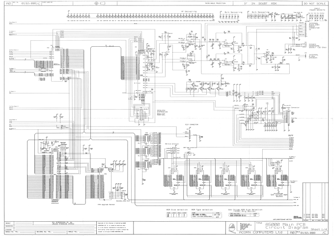

Acorn A5000 main PCB circuit diagram, sheet 1 of 4 (Technical Reference Manual). All four sheets plus the power-and-ground sheet are on the wiki at Acorn A5000 Circuit Diagrams. (Source: The Centre for Computing History.)
