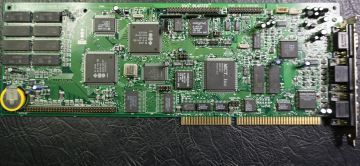

3DO Blaster CT6110. The backup cell is at the lower left, and most of the electrolytic capacitors are near the bracket.
The Creative 3DO Blaster has no moving parts of its own. What needs looking after is the backup cell for the save memory, the electrolytic capacitors, the cables and connectors that tie the card to the PC, and the Creative CR-563 drive it reads discs from.[1][2] Creative published a user's guide but no service information for the card.[1]

The card keeps game saves in 32 KB of SRAM backed by a battery.[1] On the CT6110 photographed by archive3do the cell is a coin cell with solder tabs, in a yellow sleeve at the lower left corner of the card.[2] Creative does not give the cell type, so read it off the cell before ordering a replacement. Changing the cell loses the saves unless 3 V is kept on the SRAM while it is changed, and Creative never released software to copy saves off the card.[3][4]

The card carries about a dozen small radial electrolytic capacitors, most of them in the audio and video circuits at the bracket end and a few elsewhere on the board.[2] Neither Creative's guide nor the Console5 TechWiki lists them, so photograph the board and note each value, voltage and polarity before replacing any.[1][5] For the signs of a failing capacitor see Capacitor Failure Symptoms.
