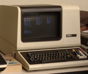

The tables below list the electrolytic and tantalum capacitors in the DECmate I (VT278). Every value comes from DEC's parts lists in the VT278 field maintenance print set, MP-00900 (May 1981).[1] The aluminium electrolytics are on the monitor board, the keyboard and the optional DP278 communications board. The M8436 CPU module and the I/O connector board use solid tantalum capacitors only.
The VT278 contains a CRT and a mains switching power supply. Read CRT Discharge Procedure before removing the monitor board, and see Capacitor Failure Symptoms for what failed parts look like.
