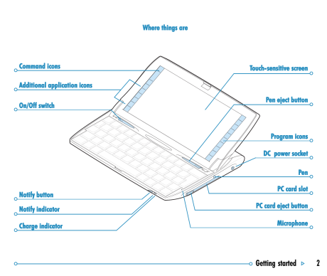

Psion's own layout diagram for the netBook. Everything on it is shared with the Series 7.

Preventive maintenance for the Psion netBook.
The netBook is mechanically identical to the Psion Series 7 โ€” same case, board, screen, keyboard and battery โ€” so the general care, disassembly, battery and screen-cable advice lives on the Psion Series 7 General Maintenance page and is not repeated here. Read that page first.
