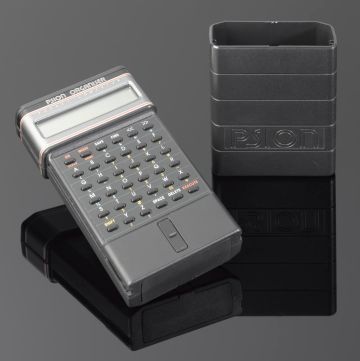

The Series 1 with its sliding cover off. The cover is held by a spring catch and comes away with a firm downward pull; the battery cover is behind, on the back of the machine.

  2. Slide off the protective cover. Grip it just below the separation point and pull firmly downwards; it is retained by a spring catch and comes right off.[1]
