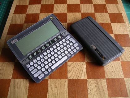

A Series 3a. Three habits keep one alive: open the lid squarely, keep the batteries out when it is stored, and never prise the mainboard with the SSD doors shut.
Preventive maintenance for the Psion Series 3a. Most of it applies equally to the Psion Series 3, Psion Series 3c and Psion Series 3mx, which share the case.
The Series 3a is electrically robust and mechanically fragile. What fails is the hinges, the button bar, the screen ribbon and the battery lead — and every one of those is affected by how the machine is handled.
