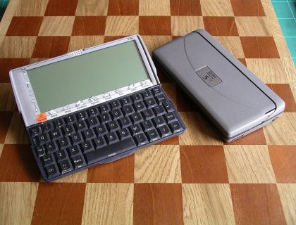

The 5mx. Everything that goes wrong with these machines is mechanical or connector-related, and most of it is preventable.
Preventive maintenance for the Psion Series 5mx.
The 5mx is electrically reliable and mechanically fragile. There is no capacitor plague, no notorious chip and no recap tradition โ€” what fails is the screen ribbon cable, the hinge-wire hooks, the flat flexible cable connectors and, if you neglect the batteries, the board.
Most of that is preventable. This page is about the habits that keep a 5mx alive.
