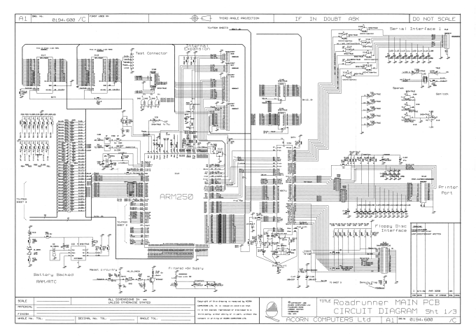

Acorn A4000 "Roadrunner" main PCB circuit diagram, sheet 1 of 3 (Technical Reference Manual), showing the ARM250, the battery-backed RAM/RTC, reset circuitry and the filtered +5 V supply. Sheets 2 and 3 are also on the wiki. (Source: The Centre for Computing History.)

If the rails are good but the machine is dead, the fault is on the main PCB. Acorn's procedure is to inspect the board, then run the functional test software:[1]
  • Check the ROMs are correctly seated with no lifted pins, and the configuration links LK10, LK11, LK12 and LK14.
  • Because the ARM2, MEMC1a, VIDC1a and IOC are inside the ARM250, the bus-level checks used on the discrete-chip A3000 (clock present, reset released, DRAM RAS/CAS, address lines incrementing under a held reset, data bus not stuck) apply here at the ARM250 pins and the RAM. If the clock, reset and rails are present but the ARM250 produces no bus activity, the ARM250 itself is the suspect — it is a whole-device replacement.
  • As on the A3000, do not leave a board powered with no clock: loss of DRAM refresh can damage the RAM.
