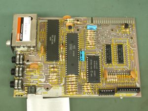

Sinclair ZX81 main board
The Sinclair ZX81 is a small, simple machine: one supply rail, one custom chip, two electrolytic capacitors and no battery. Most of what fails on one is mechanical โ€” keyboard tails, edge-connector contacts, dry joints โ€” or arrives through the external power supply.
Observe ESD precautions when the board is out of the case: wrist strap, antistatic mat.
What is on the board
Sinclair's own component list.[1]
ZX81 semiconductors and key parts
Ref Part Notes
IC1 Sinclair Logic IC (ULA), 40-pin Called "Sinclair Computer Logic" on the circuit diagram. Does the video, keyboard scanning, tape I/O and chip selects that the ZX80 did with twenty 74LS packages
IC2 2364, 24-pin 8 KB ROM
IC3 Z80A or D780C-1, 40-pin The CPU. Not the regulator
IC4 MK4118, 24-pin 1 KB ร— 8 static RAM. The diagram notes the position will also take a 4816 2K ร— 8 part in a 28-pin pack
IC4a, IC4b ยตPD2114LC and ยตPD2114LC-1, 18-pin Alternative to IC4: two 1K ร— 4 static RAMs
REG 7805 The 5 V regulator, bolted to an aluminium heatsink with a 4BA nut and bolt
TR1, TR2 ZTX313 Video output stage and master oscillator
D1โ€“D8 1N4448, 1N4148 or 1S4A Keyboard matrix diodes
X1 CDA 6.5MC Three-lead 6.5 MHz ceramic filter; the ULA divides it to the 3.25 MHz CPU clock[2]
MOD UM1233 UHF modulator, channel 36
KB1 / KB2 5-way / 8-way Keyboard tail connectors
Resistor packs RP1 (8 ร— 10 k) and RP3 (5 ร— 10 k) are fitted on the Issue 1 board; RP2 is not used, and R3, R30, R31 and R32 are not used either.[1]
Board issues. At least three PCB versions exist. Component reference numbers are the same on all of them. The notable Issue 3 difference is that RP1 and RP3 are replaced by individual resistors, R35โ€“R42 and R43โ€“R47 respectively.[2] Work from the issue number silkscreened on your own board.
