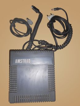

MP-1 with its DIN, 5 V DC and aerial leads

The Amstrad MP-1 is a mains power supply and UHF modulator that lets an Amstrad CPC 464 run without an Amstrad monitor and display on a domestic colour television. It takes the place of the monitor: it powers the computer through the 5 V DC socket and takes the video from the 6-pin DIN socket marked MONITOR. Amstrad offered it to owners who had bought the CPC 464 with the GT64 green-screen monitor and wanted the computer's colours.[1] The MP-2 is the equivalent unit for the Amstrad 6128.[2]

Larger plug, 6-pin DIN Computer socket marked MONITOR
Smaller plug, DC power Computer socket marked 5V DC
Aerial plug Television aerial socket
MP-2 only: socket on the rear of the MP-2 The computer's own 12 V DC lead
Mains lead Mains supply, with a 5 A fuse in a 13 A plug; the CPC 6128 manual gives 220–240 V 50 Hz for the MP-2
