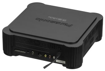

The Panasonic FZ-1 is now more than 30 years old. Its power supply is part of the main board and its capacitors are the usual cause of faults; the tray belt and the laser are the parts of the CD-ROM drive that wear.[1] The disassembly order and part numbers below are from Panasonic's service manual and its supplements.[2]
