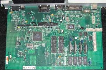

Acorn A4000 "Roadrunner" main PCB (part 0194,600). The ARM250 is the large square package; the two RISC OS 3 ROMs sit beside it, with the RAM and expansion-RAM cards at lower right and the IDE/floppy connectors on the right edge.

The machine and its board
The ARM250 integrates the four chips that were separate on the Acorn Archimedes A3000 — the ARM2 core, MEMC1a, VIDC1a and IOC — into one package running at 12 MHz.[2] Because of this, there are no socketed processor-family chips: a failure inside the ARM250 means replacing the whole device. The board is part 0194,600 ("Roadrunner"), the same board used by the A3020.

⚠️ CMOS backup battery
The A4000 keeps its configuration and clock in battery-backed CMOS RAM, with the cell at the top-right of the board.[2] As on every Acorn machine of this era, an ageing backup battery can leak and corrode the surrounding tracks. Inspect it on any unrestored machine, clean any residue with isopropyl alcohol, check the nearby tracks for continuity, and replace the cell. Lost configuration, a wrong clock or boot problems are the usual symptoms of a failed cell.
