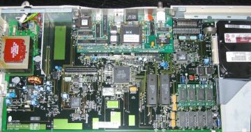

Acorn A3020 "Heron E" main PCB (0194,500). The ARM250 is the large square package centre-board; the RISC OS ROM is above it, the 2.5-inch IDE hard disc sits top-right, and the on-board mains PSU (transformer and red suppression capacitor) is at the left edge.

The ARM250 integrates the ARM2 core, MEMC1a, VIDC1a and IOC into one 12 MHz package, so there are no socketed processor-family chips to reseat or swap.[2] The socketed devices are the two RISC OS ROMs and, where fitted, the 2 MB RAM upgrade in the ZIP DRAM sockets.

The A3020 keeps its configuration and clock in battery-backed CMOS RAM. The cell is a rechargeable NiCd barrel, 1.2 V 280 mAh (Varta, Acorn part 0817.014), soldered to the top-right corner of the board, directly under the floppy drive.[3][4]
This cell leaks corrosive electrolyte even in storage, and the leakage is the single most common cause of a dead A3020. It attacks the tracks, vias, IC legs, sockets and the RF shield around the battery, and because the floppy connector sits over the battery it frequently takes out the floppy and, on hard-disc machines, the IDE drive as well.[4] On any unrestored machine:
