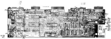

The Amstrad CPC 664 has twelve aluminium electrolytic capacitors on its main board, in four values. The values, circuit references and Amstrad part numbers below are from the CPC664 electrical parts list on page 21 of Amstrad's service manual.[1]

C129, 47 µF 10 V, sits across the 5 V supply beside the 0.1 µF decoupling capacitors C101–C128. The parts list gives C314 the same part number as the other 1 µF parts, but the cassette control circuit diagram marks it non-polarised (NP), so fit a bipolar part there.[3]
The 664 has no cassette deck, but it keeps the cassette interface for an external recorder: the LA4140 and LA6358S (IC301, IC302; the parts list prints the second as LA63585), the motor relay RY301 and the 5-pin DIN socket J302.[1][3] That is why most of the electrolytics carry 300-series references.

[edit | edit source]A note under the parts list says no part numbers are given for anything on PCB30001, the board on the drive mechanism; a faulty board was to be returned to Amstrad with the whole mechanism for replacement.[1] The disc control circuit diagram on pages 35–36 of the manual is the schematic of that board and shows its capacitor values, for example C101 at 3.3 µF / 50 V. The drive board numbers its parts independently, so its C101 is not the main board's C101, a 0.1 µF ceramic.[4]
