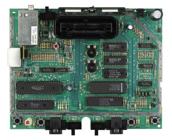

NTSC 7800 board; the RF modulator (C024629) is the metal can at the top left
Every NTSC and standard PAL Atari 7800 has RF output only.[1] A composite mod takes the video and sound from inside the console instead. ConsoleMods describes the range: simple composite mods that tap the video going to the RF modulator, and S-video mods that use the separate chroma and luma signals from MARIA and the TIA.[1] The widely documented modern route is the Ultimate Atari Video (UAV) board.

  3. Find the video resistors to the right of and below the RF modulator.

TBA's manual adds that on an NTSC "Rev A" board the UAV can be fitted as shown in its photograph without cutting or removing anything, working in both 2600 and 7800 modes and leaving the RF output working.[4]
