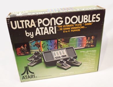

Ultra Pong Doubles
Ultra Pong Doubles (C-402(D)) comes with four hand-held controllers. Two players use the inner "A" jacks on the back of the console; plugging the other two controllers into the outer "B" jacks turns every game into a four-player version, with the playfield divided into quarters and each player's paddles confined to one quarter. That gives 16 two-player and 16 four-player games, 32 in all.[2] Sears sold it as Pong Sports IV (99708). Pong-Story notes that the 16 Pong games in Sears's Motocross console are the same as those of Ultra Pong Doubles and Pong Sports IV.[1]

[edit | edit source]-
Ultra Pong Doubles box: "32 game variations, 2 to 4 players"
