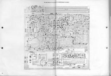

The PC-MM has a single switching transformer, T501. The parts list gives its switching regulator, IC501, as an STK7356, but the PC-MM schematic labels IC501 STK7358, so read the part fitted before ordering one. The control ICs are a BA6993, LA6324 and BA707 (IC502–IC504), with two TLP580 optocouplers (Q504, Q505), and the IC protectors ICP501 and ICP502 are ICP-N50 parts.[2] The parts list leaves out the small electrolytics of the supply's control circuit; the schematic shows C506 (1 µF 50 V) and C509 (0.22 µF 50 V) beside IC501.[2]

- Photograph the board and note the value, voltage and polarity printed on every electrolytic in the supply area. Repairers have found PC-CM boards that differ from the layout drawn in the manual, with parts moved and renumbered.[4]
