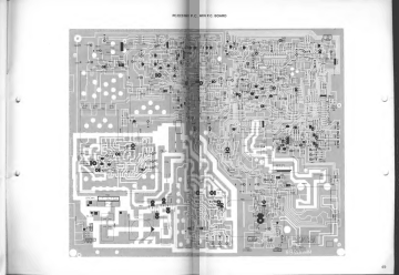

PC-ECD main board, which carries the computer's supply (service manual p. 49)
The Amstrad PC1640 takes its power from whichever monitor it was sold with, the PC-MD, PC-CD or PC-ECD, so the capacitors that keep the computer running are on the monitor's main board.[1] Amstrad's service manual lists the electrolytics of all three monitors. The CPU board's parts list names only C801 (47 µF 16 V); the other electrolytics on the CPU board are not listed, and one of them, C124, is a known failure.[2] The procedure is the same as for the PC1512's monitors; see the Amstrad PC1512 Capacitor Replacement Guide.

C124 sits on the +5 V feed through R181, the 5.6 Ω fusible resistor that powers IC110 (74LS125). On one PC1640 it failed short, burning out R181 and causing the BIOS's floppy controller error; owners give it as 100 µF.[3] Amstrad's PC2086 parts list, for a later board of the same family, also gives C124 as 100 µF (10 V or 16 V).[4] Read the value and voltage printed on the part in your machine before replacing it, and replace R181 at the same time if it has failed. The Amstrad PC1640 Troubleshooting Guide has the full fault report.

PC-ECD electrolytic capacitors
PC-ECD electrolytic capacitors (service manual p. 46)
Ref Value Voltage Amstrad part no.
C465 2.2 µF 50 V 175144
C429 4.7 µF 100 V 175116
C440 22 µF 250 V 171649
C506, C601 150 µF 400 V 171450
C515 220 µF 160 V 171651
C613 330 µF 25 V 171652
C516 470 µF 35 V 171653
C457, C623 1000 µF 16 V 1422158
C441 1000 µF 35 V 1422159
C427 2000 µF (as printed) 35 V 1422160
C621, C622 3300 µF 16 V 171654
C618 3300 µF 35 V 171655
C427 is printed as 2000 µF but carries part number 1422160, the number used for the 2200 µF 35 V C408 in the PC-CD list; check the part fitted. The 150 µF 400 V reservoirs carry part number 171450 here and 171650 in the PC-CD list.[2] C505 on the PC-ECD is a 2200 pF 125 V ceramic capacitor, not an electrolytic.[2]
The PC-ECD's TTL decoder board is soldered to the main board. An owner who recapped it had to desolder the board to reach its capacitors, and lifted a track at C118 in the process; the schematic let him repair it.[6] In that monitor the black screen turned out to be a failed 5 V regulator, IC503, not the capacitors, so measure the supply rails before recapping.[6]
