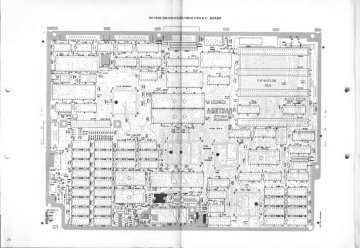

Floppy controller error
[edit | edit source]"Error: Faulty Floppy Disk Controller or Disk Drive" appears when the BIOS cannot make drive A: seek. The disc test is treated as fatal, so a PC1640 with no working drive A: will not reach the boot prompt.[3]
- Check that drive A: is powered from its Molex plug and jumpered to the first drive select (DS0), and that the card-edge connector is the right way round; a drive LED that lights as soon as the power is applied means the cable is reversed.[3]
- Test the drive in another PC if possible.
- If the drive is good, watch drive select 0 during the self-test. On a working board, pin 2 of IC117 (74HC240) goes high, and pin 18 low, a few seconds after switch-on, and the drive LED comes on.[3]
- If drive select never changes, the floppy controller's interrupt may not be reaching the interrupt controller. The interrupt passes through IC110, a 74LS125, whose +5 V supply comes through R181, a 5.6 Ω fusible resistor.[3][1]
On the board in this report, R181 had failed open, leaving IC110 without power. A new resistor smoked within seconds because C124, a 100 µF capacitor on the same feed, had failed short. With C124 removed and R181 replaced the machine passed its self-test and booted.[3] Replace C124 as well as R181; the owner used a 5.1 Ω ¼ W fusible resistor, and other owners measured about 5.8 Ω across a good R181 in circuit. Amstrad's parts list gives R181 as a 5.6 Ω fuse resistor, part 175089.[3][1] See the Amstrad PC1640 Capacitor Replacement Guide.
