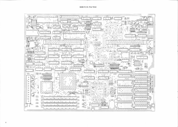

[edit | edit source]- Stripes on the screen from the moment power is applied, a single flicker of the keyboard LEDs, and nothing more: reported on a PC2386 after it had run for some hours following a supply repair. The owner had removed all cards and tried a second set of SIMMs; voltages and clocks were present and the reset line went high briefly then low. Others have linked stripes on this machine to RAM faults, but the report was not resolved.[2]
- The board does not output POST codes to an ISA diagnostic card.[2]
